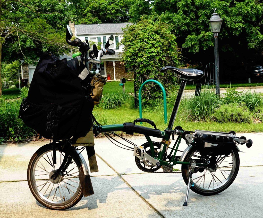

Can you show a picture of this mounted to your Brommie?
Here is the bike with a fully loaded T-bag, supported by a stand mounted about as forward on the chainstay as one can afford. There is a Kamoya stand that mounts next to the rear triangle hinge, and avoids interference with either the pedal or fold, but it is wobbly and ends up supporting less maximal load than the pictured stand.
