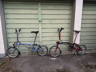

Well, as an update, I hired a C-Line Urban 3 speed from Brompton Dock over the weekend for a direct comparison.
The differences are surprisingly minimal; I think changing back to the Brompton saddle will help a lot, as the Rolls saddle I currently have doesn’t go anything like as far forward on its rails. Fine for when I was riding longer and faster when it was a S-model, not quite so practical with the more raised bars. A little tweak of the handlebars made quite a difference too.
I was also very pleased to discover that there is not much difference between my 2009 bike and the current models. (I upgraded the shifters and brake levers when I swapped the bars - a definite improvement functionally and aesthetically on the rattly bunny ears shifters). So a) I don’t need to worry about trading in my old faithful and b) I can justify a titanium seatpost to replace my rusting chrome steel one 😁
