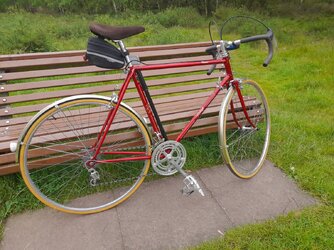

Vintage raleigh. 40 years old. Original wheels, and they are cracking in several places so I think they need replacing. It is a 6 speed rear free wheel (?) If I change the wheels, I am thinking about changing the drive chain as well. Reviewing my options before deciding whether to sell it or spend money on it.

OP - looks like a nice bike (Clubman?) - have you considered just rebuilding both wheels with new rims? That way you could keep the rest of the drivetrain.
As Ajax mentions another alternative would be to ease out the rear end to fit some more modern gear in there; and while I'd love a retro-modern build such as this, I think it would be a shame to do that to yours as it looks pretty original and in nice nick.

It is absolutely IMMACULATE. I'm considering all options. I was keen to keep it as original, but now the rims need replacing, and the spokes are not stainless steel then I feel that new wheels are the way to go. Tyres (original) could really do with being replaced as well. If I go 700c, there could be quite knock on effect. Including brakes
