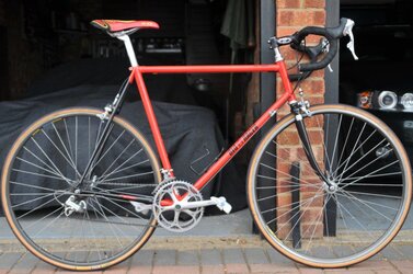

I have a Bio Racer "personal" bike which has all Durace cranks, brakes and sprocket / gears. On the basis of this kit I assume the frame to be of "good" quality. I know that Bio racer did a bike measurement system back in the late 80's and am assuming this was a product of that system. However the only indicator to the frame manufacturer is the following label which appears on both front forks and the frame; STYU 878 Mannesmann tubing.
Looking for any help in finding out a bit more about this frame. Although I purchased it second hand in the UK it has the brakes reversed so assume it was originally possibly a Belgian bike. Any info would be appreciated.

Hope these help. If different view will be more useful please let me know. The saddle it came with was a Royal Girardi and the bars and stem have been changed otherwise everything as I bought it. The Saddle stem is Dura ace as are the cranks but the chain rings are SG, otherwise pretty much everything is Dura ace, hence my assumption the frame should be reasonable quality.

Hi Keith. I have two custom Bioracers in my 'stable', both acquired through the now defunct Buckley-Saxon Cycles of Castle Hedingham. The earliest frame was built for me in July 1991 and looks to be the same red as yours. The second frame was actually built for my son and dates from April 1994. This second frame has the same stickers as yours and has a noticeable degree of elliptic tube shaping of the seat and downtubes at the bottom bracket, which makes it a bit stiffer laterally than the earlier frame.
I cannot remember much about what I was told about the tubing at the time but I do remember that the Reynolds 753 was king-of-the-hill then and I was given the impression that the Mannesmann stuff was its equal, although I suspect this was perhaps a bit of 'marketing' speak at the time! I would say though that the material was certainly good quality tubing and worth hanging onto if you're minded to go with steel.

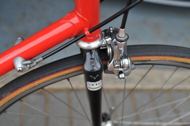

Didn't Bianchi engrave/stamp a stylised 'B' on some of their fork crowns ?

Have just been looking and found a comparison between a Bianchi and Trek frame and lugs and whilst it was using cro mo frames in the early 80's it clearly shows a "B" stamped on the crown forks very similar to the one on mine although picked out in a different colour. It does also show a "B" on the rear forks but mine are not flattened at the seat post end like those on the 80's bike so not perhaps as easy to do.
So am thinking perhaps bike designed for a particular individual using the Bio Racer system and the info sent off for a computer print-out to be drawn up for the frame builder. The frame is then put together in Belgium using, possibly a Bianchi frame construction. Obviously the other components could have been a specified requirement to the builder or could have been fitted by the owner as in Ploddin Pedro's case.
The seat stem is elliptical but not so much at the down tube bottom bracket end. So it may have been around the early nineties, between Ploddin Pedro's two Bio Racers.

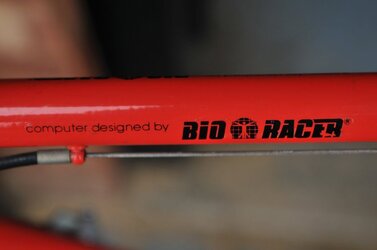

I'm the chap to whom PloddinPedro refers, who used to work at Buckley-Saxon Cycles in Castle Hedingham. The information he's given you is good, and I can add very little, really.
We were agents for BioRacer for several years - from their introduction to the UK market until they ceased frame production a few years later. They were around in the early 90s. As has been stated, the designs were based on an early (the first?) personalised, computer-designed geometry derived from measurements we took, and the frames were built in Belgium.

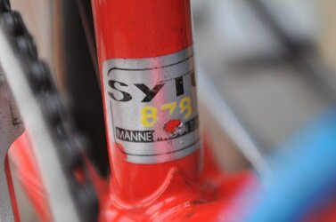

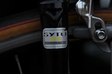

The tubing is Mannesmann, as you say. It's not like 753 - much heavier. It compares better with 708, or maybe Columbus SL. It rides well; I still have two BioRacer frames, and got some of my best results riding BioRacers. Those forks don't look original, so the Bianchi theory could be right, BUT if that's a Sytu decal on them then I think it's unlikely, and that my memory is defective; I don't think I ever saw the tubing used by another builder, though presumably some did.
The stays have definitely been repainted; BioRacer powder coated their frames (no chips in mine after 20 years), and they were one colour only. The most radical their frame finishing became was to offer a contrasting fork colour (so the black forks prove nothing). I'd have a look at those stays carefully - they may have history if they've required repainting.

Many thanks for the info. really interesting, the whole history. I have looked closely at the whole frame and found that I missed a "B" impression on the bridge between the rear forks and where the brake mechanism is located. It is the same style as that on the crown of the front forks.
As to the colour, there is a small (2 mm) mark where at some time there has been something rubbing, probably the tail of the front brake cable, against the forks where it is black and you can see that it was originally all red and the black is a coat laid over the top, that is what I am assuming.
