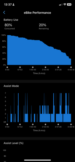

No idea about the Wahoo, but I paired my Orbea Gain with Garmin 530 and Edge Explore 2. Wasn't able to adjust power level from the 530 but could see all the data. I'm not sure if it's possible on the EE2, I'll have to look into it.
Quite nice to analyse battery usage over the whole ride.

I don't know about the Wahoo, but I've just tried my Edge Explore 2 with my Ribble (Mahle X35 motor) and you can adjust the assistance level from the Edge.
I added the appropriate data screen and fields to the Mountain Bike preset profile and renamed it to E-bike.
Edit - pic below is of the added Garmin screen. The assistance level is changed using the + or- symbols on the touchscreen
