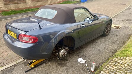

So unsure on ‘what’s next’. But I’m spending 3/4 of a day today - removing wheels, then cleaning up under the arches and getting some minor paint done on a couple of tiny areas under there; and painting the brake surrounds / dust shields. Just to make it all A1+ and give no-one any reason to moan……

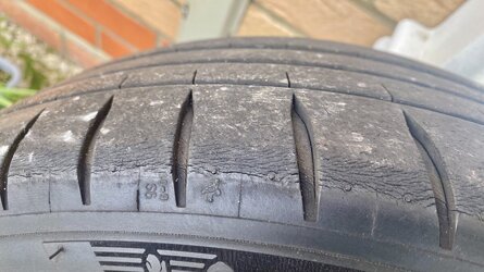

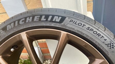

As a slight aside to the above: Michelin Pilot Sport 4 tyres - approx 18 months old with 10k on them; and 5-6mm of tread right across all 4. BUT - showing signs of cracking only on the very outermost tread block. (Close up / high def pics likely make look worse than actual. But it’s clearly there). This likely to be an MOT failure or ? 😳
Wondering if I have a valid claim here ? All 4 are the same. On a £500 set of premium tyres…….
