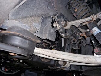

Today's job is to clean and grease all the caliper slider pins on the MX-5. It has a full main dealer service history but they won't have been touched in 10 years since its original brake pads aren't even half worn.
Some MX-5s of this age are getting near to scrapping because of terminal rust, but this one never sees salted roads and very rarely sees wet roads, so it should be an easy job. It's pretty clean underneath.
