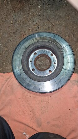

Decided seen as it was nothing to do much today, weather being mild but bloody wet, I would do the Citroen C3 front discs and pads. Didn't fancy next week when temps could drop below zero.
First hurdle corroded wheels onto hubs. In fact all were corroded on. This leads me to think it's on its original tyres, which are still fairly decent tread at 36k miles.
Once wheels were off, straight forward, job. Thump with sledge hammer to break free corroded disc from hubs. Wirewheel all corrosion away, lubricate pins with ceramic lube.
Refit new components.
Old disc were
pretty worn, pads had 25% left

The ones on our Aygo were in bad shape when we bought it - wouldn't have passed the MOT had it been done at my local garage. Similar price for discs and pads though. I've checked my van's disc prices, and even Brembo aren't too bad TBH. Tyre prices seem reasonable as it runs on XL car tyres, not van tyres.
