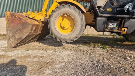

After my JCB Loadall decided to split a hose,dump almost all the transmission oil all over the place. I replaced the hoses associated with transmission cooler. JCB dealer recommended I change the transmission filter and clean the sump metal filter, incase increased pressure was the cause of failure (I suspect 28yr old rubber) and grime.
First snag, awkward filter location and seized on. I had to buy a fairly decent double chain filter wrench to go around 100 diameter filter
Oh and the 21 litres of new oil has to go in via the dipstick filler tube. Another purchase oil jug with flexi pipe and narrow end.
After 10 days, I have a running machine. Tomorrow I have to pressure wash all the oil splatter and hopefully locate where all the other leaks are.
