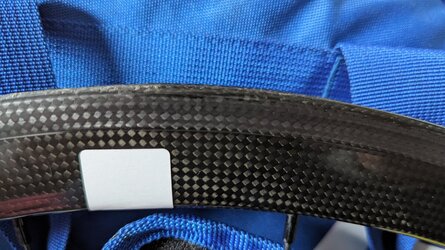

My front wheel (carbon tub) took a bit of a dink in a pothole a month or so ago. LBS recommends no more riding, so I've attempted to sell on.
I'm impatient and am currently riding my training bike which is clunky, heavy and utterly failed me yesterday on a sportive.
Now I'd like to explore carbon repair on the rim. Has anyone ever had this done, and if so was it effective? What was the cost like?

If it was down to me I'd go about fixing it. That said, I wouldn't want anyone to go out and get themselves killed based on something I'd said so you have to make your own mind up. I've got a carbon bike (second frame, first one snapped at the chain stay) and I discovered a crack on the seat tube near where you tighten the seat post. I bought a repair kit off the net and patched it. That was ten years ago at least and I still ride it. I suppose it really depends on where the problem is and is it a 'critical' area. I'd say a wheel is pretty critical. If it was me I'd at least coat it with some resin to strengthen it up. It's unlikely to be pretty but it saves throwing it away and buying another. Trouble with carbon is you never can tell, eh? I'm a tight arse, by the way, so my judgement is often blurred by the cost of the alternative solutions.

I use the term 'pragmatic' and 'stoic' rather than tight arse :laugh: we are kindred spirits. Ideally a carbon repair place will be able to quote me, then i can consider it. A repair kit is my last resort, but then I am also a tight arse...

You could "repair" it by getting a new carbon rim laced onto it, Anything else is not worth the risk. Echo thoughts above if you really were attempting to sell on.
My carbon hoops came with an optional crash / pothole guarantee, so if that happens, i just send back for a new rim

If a LBS recommends no more riding, then its not worth taking a chance with a repair that rim is scrap, either have a new rim fitted or buy a new wheel or wheelset.
As for selling it on, put a saw through the damaged rim then if some one wants to buy the used undamaged wheel and even the damaged and cut wheel for spares for the hub thats ok but never take a chance with your life or the life of another cyclist.
Perhaps keep a look out and see if you can pick up a front wheel on sale from an online bike shop or even Ebay know i tend to wear out back wheels far quicker that my fronts so unless its just myself should not be hard to find a front wheel at a good price
