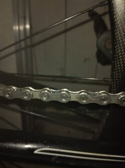

Ajax Bay
East Devon
Think maybe wrong image shared just now. That is a chain(!)

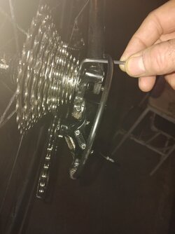

One other thing, after a couple of runs through the video upthread.
I wonder whether your FD (cage) is too high wrt the top of the large ring teeth: 1mm gap is optimal.
J
Jimmy Welch
Ok I've dropped the front derailleur and still it jumps please see attached video which shows the point where it leaves the chairing
View: https://youtu.be/RLGwFcbOZ-w?si=cbW2AM62ZnpmH9G7
Ajax Bay
East Devon
It cannot be the FD cage outer plate that's pushing the chain off the big ring: as you change up the cassette the chain will move AWAY from that.
I suggest this is a chain line issue and your chainset is too far out (hence my earlier Q).
So try this: roughly how close is the cassette lock ring from the drop out? >2mm?
