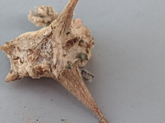

I took my bike to Albuquerque NM, 800 miles south to spend some time with family there and bought some tire liners yclept "RhinoDillo" as the goat head problem there is a pain. Goat heads are nature's own caltrops, see the pic. The thorns are about 1/4". Of course, I did not pick up any, which would have gone right through my Marathon Racers, but the liners really made riding hard work and stodgy. I do ride for exercise but feeling like I am dragging an anvil does suck the joy right out.
