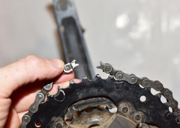

Hello to you all. I have been searching the internet for a long time and I couldnt find any answer or somebody who has the same problem as me. Bicycle stores neither have a clear answer for me. Its been 6 years that I am cycling (cyclocross and road bike). I have ridden aproximately 25.000 km (15.500 miles). My chains keep breaking before I reach 2000 km (1242 miles). I clean them every 150 km (81 miles) depending the nature of the use. Both of my bikes have 11s and I use the chain Shimano HG601 105 11v. The lubricant I use is the Muc - OFF. The yellow one for dry seasons and the blue one for the rainy seasons. I check the gears of both bikes and the problem is not there - they are not worn out. Is that normal? Am I doing something wrong?

When they break I just change them directly. I dont repair them. Only if I am on a trip and I dont have a spare chain. I am not very powerful. I would say average. 160 w. I weight 90 kilos.
Very odd.
In what way do they "break"?
Do you have a picture of the broken ends?
The parts of the attachments break and rarely close to the pins. Normaly they break as the foto I include.

Shimano HG 601. Thanks a lot.

I've never seen a single chain break like that, let alone multiple ones at low mileage. It's not normal.
Something strange is afoot, but I've no idea what.
