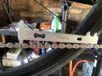

However since I got a road bike it gets much more attention, as some of you may know I’ve started waxing the chain, I got a chain checker tool and have been checking every 300 miles or so.
Generally how long do you all get out of a road bike chain? And what is your first sign of knowing it needs replaced? My bike is rarely ridden in wet and chain maintenance is very important to my routine to get as much miles from it as possible.
I’ve done 2600miles on this chain and I’ve just put the checker tool on it which seems ok.

It depends how hard you use it, the weather, the route(s) and what weight you are.
I get about 1500-2000 miles out of a road chain, but only 500-600 on my winter commuter.
My son, who's a lot lighter than me, gets about 2500-3000 miles on his road bikes, 1500 on his commuter.

Thanks. Do you just go with a standard checker tool and replace when it gets to .75?
DCLane
I do, or when it's completely filthy/rusted in the case of my winter commuter which gets all sorts of abuse.
The only time I replace chains below .75 is if I've a major event coming up or so no. 2's got a big race and we swap the chain on his spare bike (his team bike's done elsewhere).
Buy a steel rule. All links are 1/2 inch, so measure 6 or 8 inches on the top run of the chain under tension. I'll normally replace when I see 1/4" over 8" length

I use SRAM PC1110 11 speed chains and check using a digital Vernier, they get changed at 0.5% elongation. I normally get 1200 - 1500 miles per chain, and 3 chains per cassette, which for me works out about once a year.
