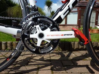

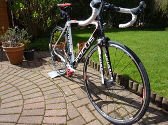

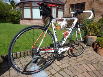

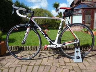

Pictures of the new steed please Nigel...:thumbsup:

Photos of my new pride and joy - Focus Izalco Pro 4 TRIPLE. Not sure on the bottle cage colour as that was a Christmas gift to go on my late Focus Cayo. Might change it to black and white.
I have a new set of Fulcrum Racing 5's with black/white Ultremo zx's which were going to be my summer wheels to go on the Cayo. I will swap these over with the DT Swiss R1850's in a couple of weeks.
I can't find the spec. for the R1850's only RR1850's and they are definitely a different wheel - spoke count to start with. I'll run the R1850's for a couple of weeks to see what they are like.
