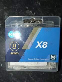

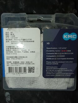

J
JackStraw
Active Member
This is the box the chain came in. KMC is a Chinese brand and this is what Bosch listed in the list of original parts.

J
JackStraw
Active Member
certainly the "fake" I believe I ended up with came from a reputable online shop/LBS concern, but it was in the 2020/21 period when kmc chains were out of stock seemingly everywhere, or going for twice the price and they were selling these at the normal price. I cant remember if anything stood out about as different, I mean Ive seen fake Shimano components and the packaging is near identical you wouldnt notice it unless you were specifically told to look for it.
I think your observation is correct. There should be a separate thread to keep track of this kind of things because I never really considered the possibility that the market of bicycle consumables like chains can be contaminated with fakes.
Buying a cheap / no-name chain is one thing but ordering an item of a known brand is another it does not matter if from eBay or somewhere else.
These days many German brands are no longer German but all Made in China. I would expect Bosch to recommend some German chain makers but I reckon there are none to be found.
