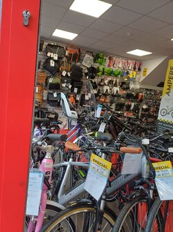

I am thinking of cycling my toddler to nursery rather than driving him. I think it is do-able. It is three miles, but there are cycle paths most the way there. If you look at the picture you should see a bicycle with a child seat near the handlebars with a windshield. It could be a good excuse for an n+1 purchase. On the other hand, I have an underused bike with quite a good rear rack. I hear Hamax child seats are the best. With the child sitting up front, I would be worried about how stable the bike was. On the other hand, my toddler might enjoy it more because he could see where he was going.

I forgot to attach the photo of the bicycle in the bikeshop with the child seat up front.

I've recently seen one with the screen and was quite impressed. It's easier to dismount with the kid in front imho, my mate dropped his bike and son when he got off and the weight of everything caused the back wheel to kick out, luckily they both survived. I see a fair few trailers about with kids in and also a couple of cargo type bikes with the box at the front with the kids in. I personally used an Adams trailer a bike when yound oxo hit about 3yrs of age. He loved it. Depends on the age of your toddler and how trustworthy they are. Good luck choosing.
