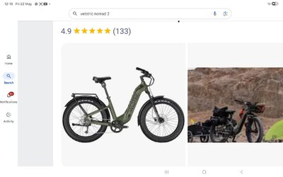

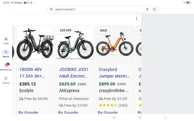

Confusing array of e bikes
I'm looking for a step through e bike and it seems like there are multiple confusing brands but the bikes all look like the same one, from £700 to £1500 ?
Are they actually better or worse or is it just paying for a real brand name and warrenty back up rather than straight from a China ?
