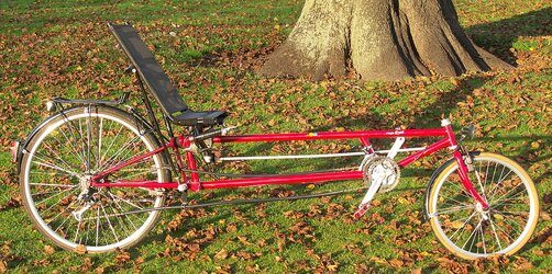

Is that where your avatar pic comes from? The grim reaper always follows you when you ride a bike without handle bars :eek:
It's underseat steering.
That's the purpose behind the rod to the front wheel. You can make out the handlebar end just below the base of the seat.
classic33
Leg End Member
Oh I see! Not sure that makes it much less scary looking!
It's a position much closer to where your arms and hands would be in, when seated.
Like anything different it can look odd/impossible when first viewed.
a.twiddler
Extremely comfortable, works very well. Your hands rest naturally, with fingertip control. More common on touring orientated recumbents as for those who want to maximise speed, above seat steering gives more options for a narrower, tucked in riding position.
