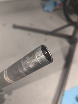

The frame is carbon, the steerer tube has split at the top, roughly where the upper part of the stem clamps around it, and after a few miles this causes the headset to slacken off. Also there is a fair bit of corrosion around the crown area. As well as that the springs have gone in the calipers and I cant replace them as the bolt attaching them to the forks has seized :cry:

So the steerer tube is composite too? Sounds like you've had a lucky escape in noticing the damage given how rapidly / unpredictably they can fail - not much fun if the front collapses / bars fall off in your hands at speed.. I hope you're not riding it any more!
I'm sure the ongoing forum debate about the safety of carbon fibre would welcome some more fuel chucked on the fire if you fancy putting up some pictures :tongue:
Sounds like a tough call tbh; I'm always wary of composites but all for keeping stuff out of landfill and if the frame's otherwise good it seems a shame to bin it. Equally if it's had a hard life and you've had your money's worth maybe it's time to retire it - sounds like it's done you very well financially. Is it possibly worth getting it inspected if you have anyone local with appropriate (ultrasound or X-ray) facilities...?
Were it any other part / material I'd suggest keeping it going with a used or budget item, however with something so highly-stressed / safety critical and in that material I'd urge caution - tbh my mind keeps coming back to that poor doctor / med student who was paralised when the carbon fibre fork on his new Planet X fell to bits :sad:
Perhaps you just need to wait until someone less pessimistic comes along and tells you to get one off Ali Express and bang another 40k on it :tongue:

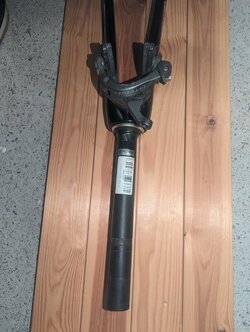

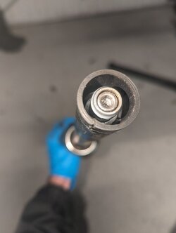

Ideally I would like to keep this bike going for as long as I can :smile: I've measured the "rake" as per THIS site and it's measuring at 16mm? I'm not sure this looks right. Is "rake" the same as "offset"? Most bike forks I've seen are about 40/50mm offset..
These forks are Wilier CM22N but I can't find anything about their specs on t'internet. Also I'm not sure if I was correct in my last post... are these forks in fact "straight" and not tapered, despite the upper and lower bearings being different sizes?
