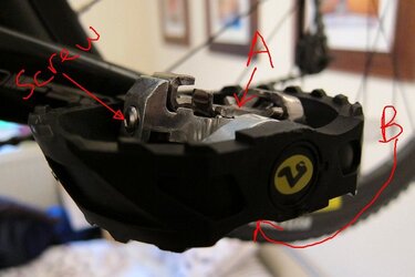

Double-sided SPDs. Which screw tightens which side?
Boris Bike
I'm starting to confuse myself here.
On this picture, does tightening the screw tighten the clips on the top (side A) or the bottom (side B)?
After a series of experiments I am none the wiser.

That Screw tightens the bottom spring clip. Look at where the screw links to - it links to the back plate - that's the bit that moves. The front plates are fixed.

Cheers. I suspected as much, but I could swear that one time it tightened the top

Both sides want to be set the same. If you look at the side near the screw there is a small Red indicator that moves as you adjust the screw. The more Red showing the tighter the clip. Set both indicators to the same amount of Red showing.

Ta - I shall take a look.
