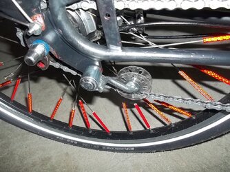

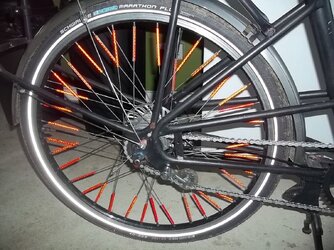

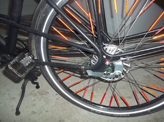

hello back again ..have given up on the Sram P5 IHG and put a Simano Nexus 8 speed in instead with a roller brake from sjs ..new anti-rotation washers for the vertical drop outs in fancy blue and green as the donor bikes were for another angle ...struggled with chain tension and tried changing rear sprocket size to accommodate however bought a tensioner from pashley which does the job.....test ride to leeds along the tow-path yesterday and it finally is a goer... still more to finesse before i am happy but thats life
