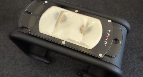

Sit bone width, many quality bike stores have a simple device to measure sit bone width similar to that shown below. Often this simple device is accurate enough to make sure the saddle is wide enough to support your sit bones; slightly wider than required is normally OK, so if a bike is being used by more than one rider you would make sure the person with the wider sit bone requirement has enough support. If it 's the front area of the saddle that is causing an issue this can often be helped lowering the nose of the saddle slightly.

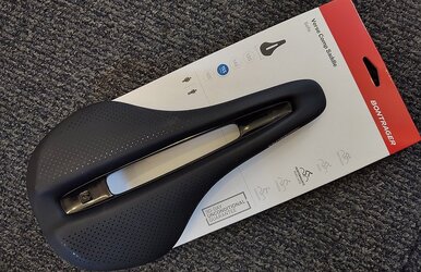

With or without a centre channel, like lowering the nose of the saddle as I referenced earlier this relates to the mid to front end of the saddle; ladies will also often desire a saddle with a centre channel to reduce soft tissue contact. A male may also choose one, the older we get as a male the larger our prostate will often become and saddle pressure can result in numbness, a centre channel or in the case of the saddle shown below a hole can help reduce that pressure.
