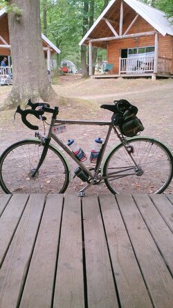

https://www.cyclechat.net/threads/56cm-single-speed-fixie-sold-and-collected.285265/
this used to be my "London end" commuter bike. When I first bought it I briefly tried it out fixed (simple job of reversing the wheel as it had a flip flop hub) but as I'd equipped it with toe straps for riding with Brogues etc, getting clipped / strapped in again was too much of a challenge plus it was a bit high geared for the hills round home. I did like the fixed feeling, but being completely inexperienced in fixed riding, I figured the capitals mean streets weren't the place to learn, so only ran as SS in London.
I was very pleased with my conversion to bull horn bars and TT levers and it was a blast to ride around the city.
