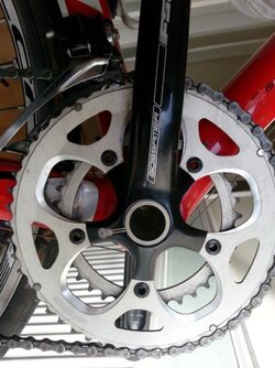

My bike came with a FSA Gossamer BB30 crankset fitted with a 53-36 chainset. I'm planning on replacing this with a Shimano 105 compact chainset and 105 BB, so that everything on my bike is 105.
I'm used to Shimano components and i'm not sure on what tools are required to remove the FSA crank. On the left crank there is some form of outer ring with 6 pin holes in it as well as a 10mm allen key bolt (see photos)
I don't want to start messing with in until i know 100% what i'm doing.
Any help appreciated.

It is just one hex bolt. Undo it.
You will need an adapter to use 105 on a BB30 frame. Depending on the adapter you use and the frame material, this can be a permanent modification. TBH, I have no idea why anyone would want to use a 105 chainset. I'd have stuck with the FSA until the chainrings were done in then gone with a Rotor chainset (or something else nice)!

Mmmm, good point. Would a 105 chainset be compatible with a BB30 botttom bracket? With adapters i assume?
You will need adapters for sure, if your frame is carbon, you do NOT want a press fit adapter unless you are happy with it being in there permanently. The 105 bottom bracket will not fit directly in a BB30 bottom bracket.

Is the FSA crank bolt a10mm then? I have a new FSA chainset to put in place of it's original 'low tech' sibling. I took the fattest hex key I could find but it doesn't even touch the sides. May I need a special big hex key (12mm or something)?

It is 10mm, left hand thread. Assuming it is the same as the Vision Trimax chainset I have, Vision and FSA are the same brand and it looks just like the one in the OP with the other small holes around it.
It is a convenient system, just like with SRAM, a single bolt and the whole crankset can be removed!
