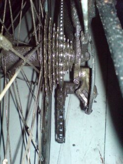

My rear derailleur is showing the following symptoms:
* doesn't want to go down to the smallest cog, no resistance from the cable and mech seems to move fine
* won't go onto largest cog without a big thumb push, as if the cable is stretching, or there is some resistance against move the mech this far.
* slow to move to a smaller cog from a larger one - it will move maybe 1-2 seconds after changing gear
* skips/jumps inbetween gears in the middle of the cogset - it's 8-speed, and generally have problems in gears 5 and 6. 4 and 7 seem to behave a lot better. I don't think it's worn cogs/chain as they were all replaced about 800 miles ago and I'd like to think they'd last a bit longer than that.
The gearing was fine until I had to fix two punctures in the last two weeks, and the problem started after the first wheel refit, and got worse after the second. I've tried adjusting the alignment barrel, but there doesn't seem to be anywhere where it's shifting smoothly in both directions.
Attached photo of the derailleur in case it is bent/damaged, but I don't think so from looking at it by eye. (nb the photo makes my bike look like something dredged up from the Titanic, but it's actually spotless)

Firstly turn the bike up and using the adjuster make sure that the chain is being presented central to the sprockets.
ATM you can see that the sprocket is touching the left of the chain in the pic.
oilyormo
gettin warmer??
