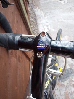

I was gifted this bike and after some digging turns out its a Gaint compact road , early mike burrows design with an interesting stem
mirage 9x 3 shifters
veloce brakes
veloce triple

Quill stem replaced with an adapter, found out the bars were bent so binned them.
replacement stem added
