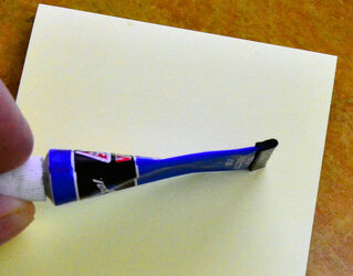

Here is a tube of Park glue. It's 50mm long. It was new when I repaired a flat on a woman's trike, and glued one patch, using it sparingly and just slightly bigger than the patch. As you can see, there isn't much left in it, and I wonder if it will be reliable next time I get a flat miles from home.

Chris S
Birmingham
Glueless patches are OK so long as you don't have to stick them over a seam. If you do then you get a slow leak, even if you try to flatten the seam first.
