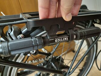

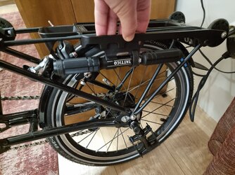

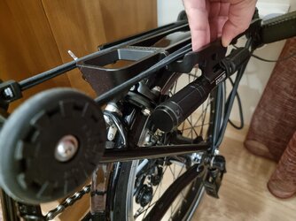

Plan on taking pump with me if I'll go on longer journeys. I have Marathon Plus and will use taxi if I'll have flat on a short ride.
Location doesn't effect the fold and I don't plan to use panniers. Will require drilling holes in the rack.l though. What do you guys think, good location for pump or better throw it in the bag if I need it?

Bad idea. If you ever use the rack the little knobs that you are covering here are intended to be used for the hooks of the rubber straps to keep the load further back to avoid heel strike. If you mount the pump this way you render your rack useless. As other have said: The Leyzine Brompton pump is possibly the way to go - or you put the pump into your bag.

I didn't think about those. While it would definitely be less intrusive option I'm concerned about two things.
1. how firm will they keep it secured.
2. zip ties would normally be made from plastic that is not UV protected. Being under the sun will slowly effect it's properties and since they will be under stress all the time they they will eventually brake. Loosing pump for once but I can't even imagine what damage it could cause should it end up in the spokes while moving.
So screwing it in would definitely be the route I'd choose but it does require drilling holes.

The Brompton does not offer too much choice here and due to the fold one has to sensibly think when mounting accessories. Brompton themselves do offer a pump and the space they intend for it is realistically the best option:
The pump is somewhat expensive at GBP 32 but there is not too much choice other than a front bag or a custom made arrangement inside the seat post. The mounting point @CEBEP intends is prone to massive heel strike (apart from rendering the rack useless). There is probably a reason for the factory solution and I am somewhat surprised that the pump was not part of the package anyway with his bike. It seems to lack the pegs for the older pump, the new one was invented just last winter and I assumed it would be delivered at least with higher speced bikes like his 6-speed Black Edition. I'd probably ask Brompton themselves if this was possibly an error or has been so intentionally. The spec for a 6-speed explore in Brompton's online store clearly states that it would be delivered with a pump:
