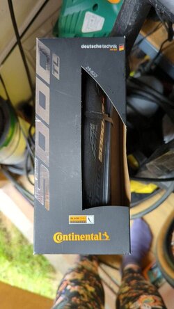

Gah - Mrs Spesh has just reported in from the shed, that they're 25s... if they're of any use you're most welcome to 'em!
Thanks - I appreciate you looking, but I'd like something a bit wider for lower pressure / comfort.
