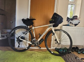

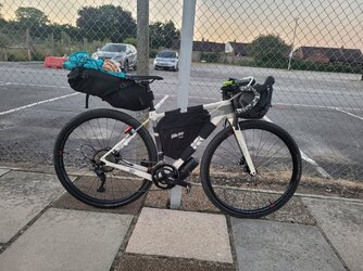

I have a gravel bike that I use for a winter road bike (and a gravel/bikepacking bike in the summer). To be honest, I spent most of this summer off-road, even though I am normally primarily a roadie. Just something about the lack of traffic I found appealing.
I have 2 sets of wheels- one with 32mm road tyres and another with 40mm gravel tyres. I have a sub-compact 2x double mullet set-up (46/30 chainset with an 11-42 cassette, running shimano 105 brifters, front derailleur and hydro brakes, and a shimano deore rear derailleur- so anything but standard). It's quick enough on the road (winter is normally slower paced social rides and well summer off-road is slower anyway).
My bike can fit full mudguards, but I take them on and off regularly so the sks raceblade xls work for me.
Anyway, my Orro Terra C in summer and winter mode...
