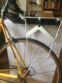

You may struggle with frame clearance if fitting 32mm wide tyres. What plans for carrying your 35 lbs of luggage as I don't think there are any pannier fittings on it as it is a pure road bike?
I figured that part out already: combo I like the beam rack because it comes off quickly to get in an out of trains, but I added some tubes of my own at bottom to carry the extra load. Looks dorky but works.

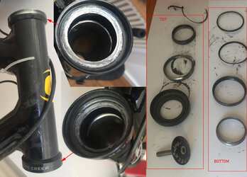

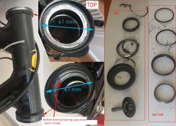

Ming, Thanks for taking time to reply. I am new to this as you can tell. If you look at the photo I posted , can you tell if all I need is to replace the bearings? For example the bearing cups seem worn- I thought that the ball bearings were in direct contact with these. Perhpas even if they are worn, the cartridge means I can re-use them...I don't know if other parts are worn: the former bearings were loose, so now I need to spec cartridges. What of all the other rings and stuff which were in the original build (see photo here)? Do cartridges replace all that as well? The cup dimensions show 41 mm according to my calipers. So would this bearing do? https://www.probikeshop.fr/roulemen...UZpfWkhWorNIfY7Yj4wtWNJde4ZcaArodEALw_wcB:G:s
Do I get the same one for top and bottom?

All the rotating wear surfaces are in the cartridges. There is some rocking movement between the cartridges and cups/crown but these generally don't wear.
Cane Creek sell original quality cartridges for this headset, or there are cheaper alternatives: https://www.rushcycles.co.uk/m49b0s...eek-S2-Replacement-Cartridge-Headset-Bearings
Thanks. I think that the fact that my old headset had loose bearings, and they really dug into the cups likely means I need to replace cups even if cartridge bearings just sit against them...

despite the load bearing "tube(s)" I would use an alloy seat post with that arrangement, as the clamp will be putting "unusual!" forces onto a carbon post which may or may not overstress it.
That's probably a good idea then. If a lot of abrasive dirt gets between the cartridges and cups it will also cause wear.
