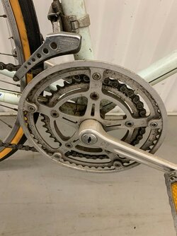

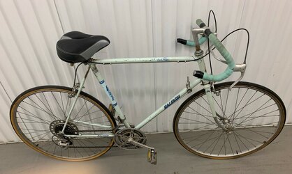

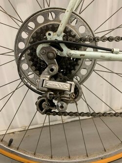

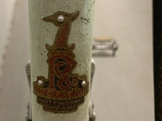

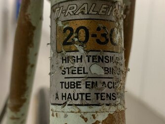

My beloved Raleigh Grand Prix has been stolen. It was purchased in Canada in the mid 1980s, and the bike shop called it a 12-speed. It was a pearlescent white with just a tinge of blue, and I believe they called the color something like "winter white." It came with black cloth handlebar tape and a black leather or vinyl seat with crosshatching on the top.
I searched online and could only find this one VERY beaten-up example on eBay Canada.
Can anyone tell me the the year of manufacture and anything more about it?
I don't even know the size. It was a men's, but a small men's. I'm a long-legged 5'5", and with the seat all the way down and tilted forward the whole way, I could just slide up onto the saddle with my toes touching the ground.
Thank you for any help in advance!

But yeah, late 80s / early 90s looks about right. I'd consult Mr Google, as there are databases with Raleigh info lurking around online. I do seem to remember that they tended to slap a load of different names onto the same frameset depending on the quality of the components that were fitted.

Suntour VX dates it to 1977 - 1982ish. That style of VX ceased in 1982 and was replaced by the VX GT with a different cage, but stock may well have sat on the shelf long enough to be on new bikes for another year or so after that.
Going with the style of the decals I would suggest the latter part of that range will be when it was born, possibly 1981 looking at that dedal style on other Raleigh products.

If you're looking to replace it there are plenty more Raleighs around that age with much better specs and gear.
I'd rather go for something built with 531 or 501 rather than the gas piping on display. Plus anything would be better than those 'suicide lever' brakes. Perhaps it's a nostalgia trip?

I have seen a Grand Prix with the exact same decals and colour. The serial number was on the back of the seat post and started with RN1.
R = manufactured by Raleigh Canada.
N = October month of manufacture.
1 = 1981 year of manufacture.
In 1983 the seat stay on the Grand Prix was changed from the previous wrap-around style.
