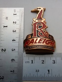

Not at all sure about this but I am intrigued by the 3-pin fixing for the head badge. The only one I can think of that fixed one at the top and two at the bottom is Raleigh:
Check out the measurements and that may give you the answer.
The fluted seat-stay tops do not look very Carlton to me, but the Carltons I knew were from 20 years before this machine.
Thanks for that @Once a Wheeler
The holes are 18 x 26mm apart, so could very well be.

Dies look like Raleigh badge holes. Quite a few had those flutes seat stay caps

Thanks for taking an interest. I couldn't resist sanding back the paint to get a better look at the serial number. I'm keeping hold of the frame in any case as it fits (60cm)
Here you can see its stamped across the the bb shell and divided by 3 slashes.
Can't make out more than a few of the digits but maybe the sequencing will look familiar to one of you.
7/?109/??/?
midlife
NB1 or WB1 at the start which is a, Raleigh / Carlton 1981 number
