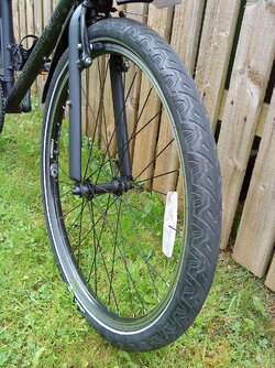

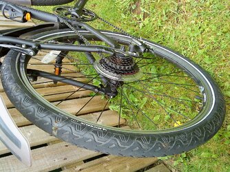

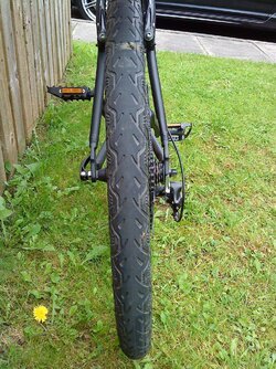

What about a set of Michelin City "Protek Plus's"(£10 each CRC)good on or off road(hard pack - not mud), or Continental Town and Country(£15 each CRC).
Michelin City's 26" X 1.85" - one p******e in 3000miles - quite a hard compound though!!
