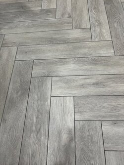

I’m doing some of this flooring from Howdens. I got a discount but it’s still about £60 a pack. I’ve noticed with all the cuts there’s about 25% waste. I think if I did the pattern the other way then it would roughly be the same cuts. It looks good but I wish I had known this before spending about a grand on it.

Looks good but sounds wasteful.

Is it floating like laminate/. Looks good, but yes, can see where you'd get waste.
Yeah but you don’t have to leave a block gap on this. It just grips its self down and you can cut it inline with your skirting board. The room looks bigger & it is nice but the wastage really is insane. Material wise, time wise & money wise. I like it but wouldn’t do it again.

I was going to say , it will look great but time consuming. I suppose careful measure of the room could help reduce waste

from a tiling point of view , 10 minutes setting out can save a lot of waste ,also careful cutting you haven't 'lost' the other part of the plank and it can be used somewhere else , obviously the smaller the room the more percentage of cuts and waste , I regularly have to tile houses with big kitchen and diner wrapping round to utility hallway and cloaks and makes a huge difference setting out

As BB says above setting out is key, the first plank you fit dictates where all the rest sit.
25% waste does sound excessive.
Is your flooring Quick Step vinyl click planks? if so it's one of the better products that Howdens sell.
