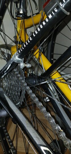

I do it with the bike right way up, mech in top gear. Step 1 is to be sure the cassette goes over the bottom run if the chain so it's inside the loop of the chain. Then try to mesh the little sprocket (or adjacent will do) with the chain run above the mech. Hand at the top of the wheel. Pull it all past the mech. Now drop everything while wiggling the rim between the brake calipers (rim brakes - remember to move the lever to open them). Should clunk into place (vertical dropout & QRs). Something like that.
More wiggling is needed for horizontal dropouts.
Oh that's clever, never seen that before.
