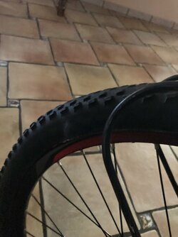

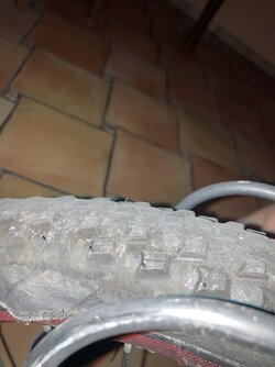

Touring with a hire bike and got an eye opener when I checked the rear tyre today. There’s a bulge and the outer skin is peeling away from the rim.
LBS is closed and the next one is 6 miles away tomorrow. Could walk it but what the failure mode?
Don’t know when this appeared but I have done 40 miles today half of which was fast downhill!!

I'd probably try to bodge repair it with zip ties to contain the bulge for the 6 miles, and take it slowly and gently.
If it does fail it shouldn't cause you too many problems as there appear to be no mudguards to get tangled with.

I would insert a nice long boot reaching underneath the tube to the other rim and ride slowly to the LBS in the morning. Or seek a local (if a 26" wheel) and see if they'd be charitable/good samaritan.

From the way the bracing is showing all the way round next to the rim, it looks like it's been ridden for miles with a flat tyre. I can't see why it hasn't already let go.

I'd contact the hire bike shop and ask what they wanted to do regarding getting it back to them. Its totally perished/had it. Is it worth your safety if it blows?

Yep, that will go 'BANG' in the not too distant future and speaking from personal experience, it ain't much fun when it happens, even if you're on the flat.

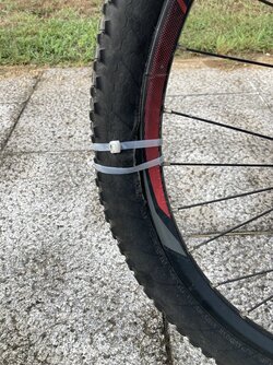

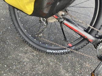

Turned out the LBS was 10 miles away as I had to keep off the main roads for safety and sanity reasons. The 2 zip ties did the job.
The LBS sorted it while I went for coffee and was surprised when the total bil was only €20. The I saw the brand.
Bike gets collected tomorrow as it’s the end of the hire. Hire bikes do get hammered so I was expecting something but not a tyre bulge. Those zip ties are handy.
A before and after pic
