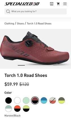

Oh yeah, as you have probably spotted he also gave me the push needed to go clipless.
May not be the "best" shoes but hey for $59.99 I think they'll do the trick for now.

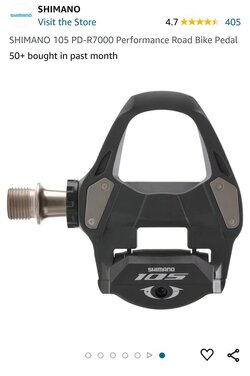

For the pedals I just "had" to go the matching route and get the 105 to represent the "groupset of the people".
These were like $150 USD but it is what it is. Gotta "pay to play" as they say.
