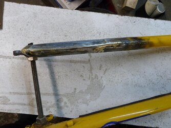

That looks fairly terminal to me, unless you're a hobbyist welder perchance.
Being the lowest point of that stick frame design, there ought to be drainage holes in that area to allow any water ingress to escape.
If no holes - could explain what's happened here.
Either way, none of this helps you I know.
Paint can hide a lot of sins, learned from having a few old crocs of cars over the years.
K
KoffMixtures
South Yorkshire
Hi Frank.
I agree with your diagnosis.
Most cycle frame tubes have vent holes, which allow welding/brazing gasses to escape and subsequently help vent moisture.
No vents on my 'Kingcycle'.
Fortunately I know a couple of frame fabricators who think it is repairable.
Certainly giving the bike a life extension, long enough for my purposes as I'm 70!
I'll post developments here.

'holey' crap ! You've been royally shafted there! Hope you didn't spend to much on it, alarm bells should've gone ding with the front brake issue..
I'd say if the previous owner was / is a member of the BHPC , try and get recompense from them, or shame them on the BHPC website.
That's not right at all
As they say, ''Caveat Emptor''.
Here's the ebay sellers response to my recent photo's of the rot I uncovered....
I'm really sorry that you've found this decay in the stays. I can assure you my sale was 'bona fide', but I guess a bike of this age may always have hidden problems. I've shown the pictures you sent to a metalwork engineer and he assures me this is repairable, it's his opinion that water has most likely entered the frame somewhere and sat in the lower section. Hope this helps, Ralf​

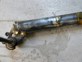

Today I dismantled it and scraped the powder coating well back from the obvious rot, which revealed the tubing is sound.
I can find nowhere obvious where water could have found its way in.

Now the frame is 'bare' my pal can do his thing with the repair skills he has, he's been fabricating motorcycle frames for over 40 years.
If I didn't know him, it would already be in the bin!

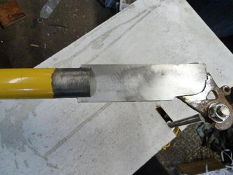

Here's an update, for anyone interested.
My pal has inserted a re-built section to the rotted chainstay.
Wheel dropped straight in with no alignment issues.
This will give the cycle a few more miles and suit the urban use I intend for it.
Certainly better than giving it to the scrap man!
