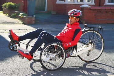

not sure if its the same spec as kmx st i got it from ebay. wheels upgraded to racing tires 20 inches wheels in front and 26 wheel rear. should be okay to have carrier/pannier at the back and swing mirror at the bar end. front lights not so sure could do with attaching front light on helmet.

i know just got that from ebay. here is another one....rack is attached to the seat frame where the rear mudguard is attached by a metal plate..... my kmx.jpg i hope this helps.

KMX make a front light bracket, rear pannier and a flag with bracket but these are for the newer range. KMX will be able to tell you if they will fit or not. I fitted a mirror to the top of the handlebars on my KMX. The only problem you might find with using the KMX for touring is the weight. My first recumbent was a KMX Cobra but i gave it to my nepfew after about six months and brought a second hand Windcheetah because i found the KMX to wide and to heavy. I had to tip it on to it's side to get through gates etc and the weight was killer. You can fit a new chainset as all the parts are normal bike parts. I removed the stock Sram X5 parts and fitted Sram X9 parts to mine.
