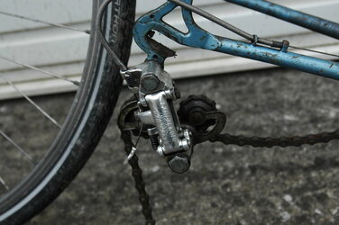

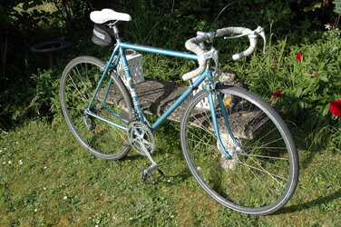

As I said , I wasn't too sure what equipment the bike came with. It had a Reynolds 531 frame, Campagnolo brakes and Campagnolo Nuovo Gran Sport rear derailleur. It turned out that the bike was equipped with a Campagnolo Nuovo Gran Sport group set. the only things missing are Campagnolo brake levers which seem to be Weinmanns. The stem is SR and the handlebars are Mavic. The wheel rims are Wolber with stainless steel spokes. The frame and forks are Reynolds 531 butted. The frame has plenty of patina! It looks a bit better with a bit of a polish and looks really nice when it sparkles in the sunshine.
I set about giving the bike a good wash and clean . The chain ,chainrings and sprockets and rear derailleur were pretty well gunged up. I set about digging the gritty mixture out with white spirit and a thin screwdriver.

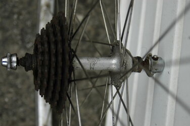

The front wheel bearings seemed okay but the rear wheel had some play in it. I discovered today that one of the cones had a groove worn into it . I haven't got a replacement so I set about reducing the step and pits in it with some 600 grit wet and dry paper. Once rebuilt it spun freely.

Viking didn't make many cycles with Reynolds 531 frames especially butted ones. It was suggested that my bike could be a reintroduced Severn Valley which was released in1978.

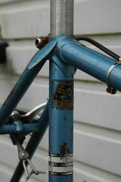

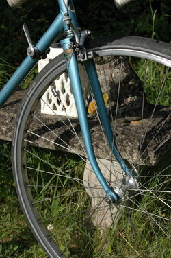

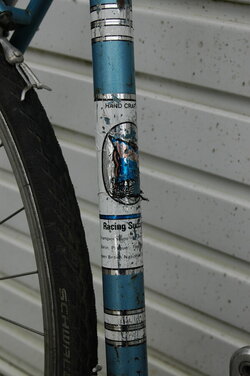

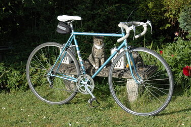

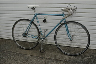

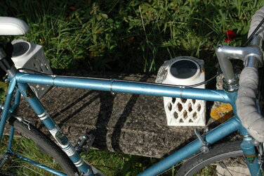

Here are some pictures of my bike.

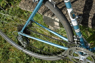

I have been out in the sunshine de rusting, treating , priming and touching in. I had to make up the colour from what I had lying around in my garage . A mixture of a very light silver blue and a drop of BMW electric blue metallic seemed to be a close match . When the paint was dry I went over the areas with clear acrylic lacquer. I missed a couple of places. The bike is looking a lot tidier.

You probably know all this, but just in case, here goes. Your Viking is from the second iteration of Viking which was based in Northern Ireland. The original Wolverhampton firm went bust in 1966 or thereabouts. It was a decent quality product, and some did use 531. I have a plain-gauge 531 model from 1980 which was called the Vision. I don't think the second Viking company used the Severn Valley name. The distinguishing feature of the Severn Valley was a slight fluting at the top of the seat stays.

It does have the fluted tops to the seat stays .
I'm not a fan of fluted stays , but I will have to put up with it .

The Reynolds transfer would date the bike from 77 to 81. This would also fit with the Campagnolo rear derailleur which has the early type pivot bolts with the engraved patent on them .

They were indeed highly successful in the sport . The transfer on the seat tube lists some of their victories .

I have discovered that the frame number which I thought had been miss stamped was actually a letter Q made up from a letter O with a 1 over stamped . This has been repeated at the end of the frame number so it was deliberate. I have read that the top of the range models were made by Harry Quinn .
