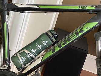

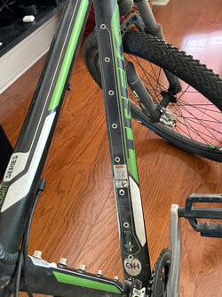

Why are mounts on the down tube so high.
Why aren't there multiple mount points along the length of the down/seat tubes.
Does an adapter widget exist that fastens to the existing mount points that effectively offers lower adjustable mount points along the tube?
Those first two questions are mostly rhetorical.

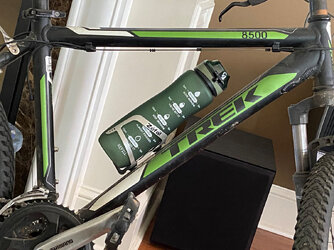

This is the existing, less-than-ideal placement:
This would be much better placement:
This would be idea!

Probably so you can safely remove and replace the bottle while moving :smile:
TheDoctor
Moderator
The TerrorVortex
Like so many things in life, it's a compromise. You want the weight as low and central as possible, but it's handy if you can reach the damn thing! Plus, bottles come in different sizes.
Ajax Bay
East Devon
for yours, the reason it is there is so that you can get another bottle cage on the seat tube, And yes, I believe there are relocation adaptors.
This ^^ and as @vickster says: "so you can safely remove and replace the bottle while moving". Maybe consider a 750ml bottle as opposed to that monster which I'd have trouble holding and drinking from safely. Maybe you are well up the dexterity spectrum.
If you must have a litre carried: go for 2 x 500ml bottles (I have 500ml on the down tube and normally 750ml on the seat tube (unless a frame bag in which case 500ml)).

Google ‘adjustable bottle cage mounts’ there are different ones available.
This one can drop your cage by up to 4.5cm.
https://www.merlincycles.com/sks-ca..._medium=Affiliates&utm_campaign=genieshopping
If you want to fit a large bottle under the downtube on my Horizon without it fouling the mudguard the ready made brackets are no use, which is why I made my own:
It has three offsets: down, to clear the mudguard, left, to clear the chainset, and away from the tube, to clear the gear cable. It's also angled to maximise mudguard clearance when removing the bottle. With the cage fitted directly there isn't room for even the smallest bottles.
