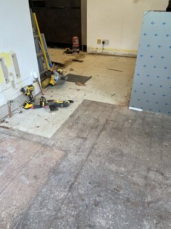

Well be spending the weekend ripping up the old ply that’s down in the kitchen , which in places has now new units on top :blush: . I’ve had a couple of quotes for Amtico , it’s gonna cost me about £2k to get done but they want a clean slate to do the prep on. Hence back to the chipboard flooring .
