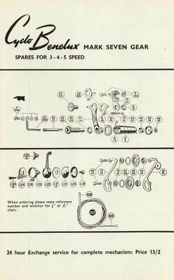

I was getting my Benelux rear mech installed and adjusted, and just when I pulled the toggle chain to attach the cable to the cable anchor bolt, all of the chain tension in the mech suddenly left. I have assembled and dis-assembled the Mk7 multiple times in the past, and thought I knew everything about them. The one thing that I have my doubts about, though, is the positioning of Spring Loc. (locator?) Cup (part # 44M). There is no slot to accommodate the end of the Taper Tension Spring (part # B13), so it rides somewhat askew. Is there any particular way that the cup needs to be positioned when fitting the Retainer Cup and the mounting nut, overall?
