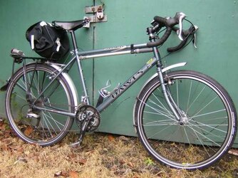

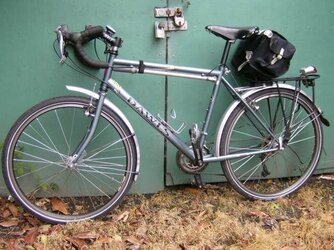

I have the same bike and have carried out the following work to it, new chain and sprockets, replaced front and rear wheel bearings, gear jockey wheels, brake pads and fitted Schwalbe Marathon 26x1.5 tyres, Brookes B17 saddle and Shimano pedals, cleats one side and flat on the other. As others have said the bike already has disc mounts front and rear.
Just get out and clock a few miles up and enjoy your riding. Most of the work I carried out was due to the previous owners neglect as he said it had been recently serviced before I travelled fifty miles to view the bike.

hubbike
yeah, doesn't look like it has great components so you might want a few upgrades...

Disc brakes are no problem as the frame and forks already have mountings which are factory fitted to accept disc brakes if required.
The wheels are 26" hence what appears to be a gap between the wheel and frame which initially appears a little strange but I use mine on towpaths and cycle tracks and never worry about surfaces due to the strength of the wheels and the width of the tyres.
Just enjoy riding the bike and clock a few miles up.
