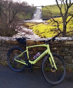

Winter is here so I've invested in a set of SKS Edge mudguards. A couple of hours faffing saw them fitted, then out for a test ride round the hills happily splashing through puddles, no rattling from the guards and no wet arse. Excellent news.
The only difficulty in fitting them was lining up the rear mudguard frame fixing. Although there is a fixing point there it seems Specialized don't understand the concept of "central" and provided the fixing hole is on the right bike it's close enough, that was easily sorted by filing away at my new mudguard. :laugh:

At least you have a frame with normal , standard mudguard eyelets, not their propiatory garbage.
No, it's got Specialized own weird stuff, that why the front guard is fixed half way up the fork :rolleyes:
I wouldn't mind but Specialized don't stock the midsize guards to fit their plug in guards any more.

You can easily bodge a mudflap from some semi rigid plastic or rubber. My commuter has some 3mm flooring rubber as a long mudflap on the front. Don't bother with a rear one unless group riding often in bad weather. That mudguard fitting mid fork isn't unusual on newer disc braked bikes.

Do those SKS guards have the usual 'breakaway' plastic bits on the fork end of the stays? It's blurry in the photo.
No, they are just the standard fixed mounts although you can get them as an extra. Now you've mentioned it I might get some.
I was thinking about that. There is still some road muck thrown up onto the motor shroud so it would be agood idea. I won't bother with the rear as I don't ride in groups, I'm too slow for that game 😆
