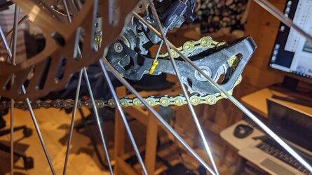

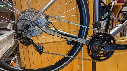

That's amazing. Are you *sure* is an SS?
Yep. Obviously I took the photo at just the wrong angle (doh!), but you can see the 'S' of the SS on the back of the derailleur. Also showing biggie-bigs and smallie-smalls.
Also shows 5mm gap between the jockey wheel and the largest cog. To reduce the tension on big-big, I actually turned the B-screw out a few turns giving a 3mm gap, which improved shifting noise a bit. I still wouldn't go into biggie-big - with a bit of chain noise on the FD at the second to largest cog, that'll be my reminder to drop down to the small chainring.
