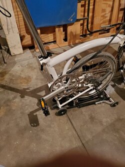

Here is mine, but I did mine Just to cover more of the chain to save my pants leg. It was made from a used chainring. I did not have any issues with my chain coming off, either before or after.

Thanks @Schwinnsta
From memory, the spider is not flat on the outside, how fiddly did you find this and what size chainring bolts did you use?
I'm definitely going to remove a couple of links. Chain came off this morning and I wasn't even peddling or changing gear. Just descending quite a steep hill. Got to the bottom and went to pedal only to find it had bounced off.
Schwinnsta
You need to file a bevel at the attachment points. I did mine several years ago, and I don't remember the bolt sizes. I made one for the Brompton and one for a touring bike. You can make these using simple hand tools. If you have the right power tools, they can save some time. But I do remember the attachment points required some filing of a back bevel. Once attached, everything is solid.
