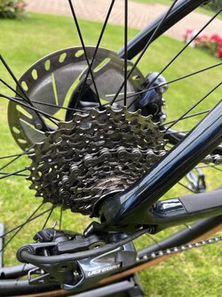

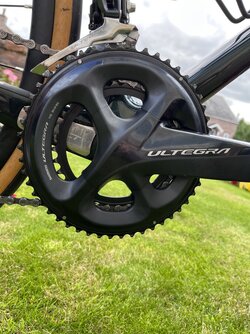

Sorry, what does the 22/34 refer to?
22 at the front is outside of the possible smallest range for Ultegra (without some special arranagement), and 22 at the rear outside the normal range for largest rear.
Just trying to understand how low your granny gear is - can you quote
(1) Smallest front chainring size (number of teeth) ?
(2) Largest rear cog (number of teeth) ?

It's impossible to tell from a photo what your rear cassette is.
The front is 50-34, so lowest chainring 34. It's likely the rear is 32 or 34, though it could be 28. You need to count them to confirm.
I'd very much expect with any of that gearing your quads to hurt on a 10% hill after a year off. If you've got a 28, I'd recommend changing to a 34. You'll likely need a new derailleur (long cage variant) if that's the case, as well as the cassette.
A more substantial change to the drivetrain would be needed to get much lower gears.

Looks bigger than a 28 to me. I think it's 32-11.
So if (by some miracle) I'm right then bottom gear is 34/32. Going to 34/34 would be nice (it's what I have) but my experience of going from 32 to 34 big sprocket is that it's nice but not game-changing. So something to have in mind for when things* start to wear out rather than a "do now" type of thing.

A quarter off the largest sprocket looks like 8 teeth so I agree it's a 32.
